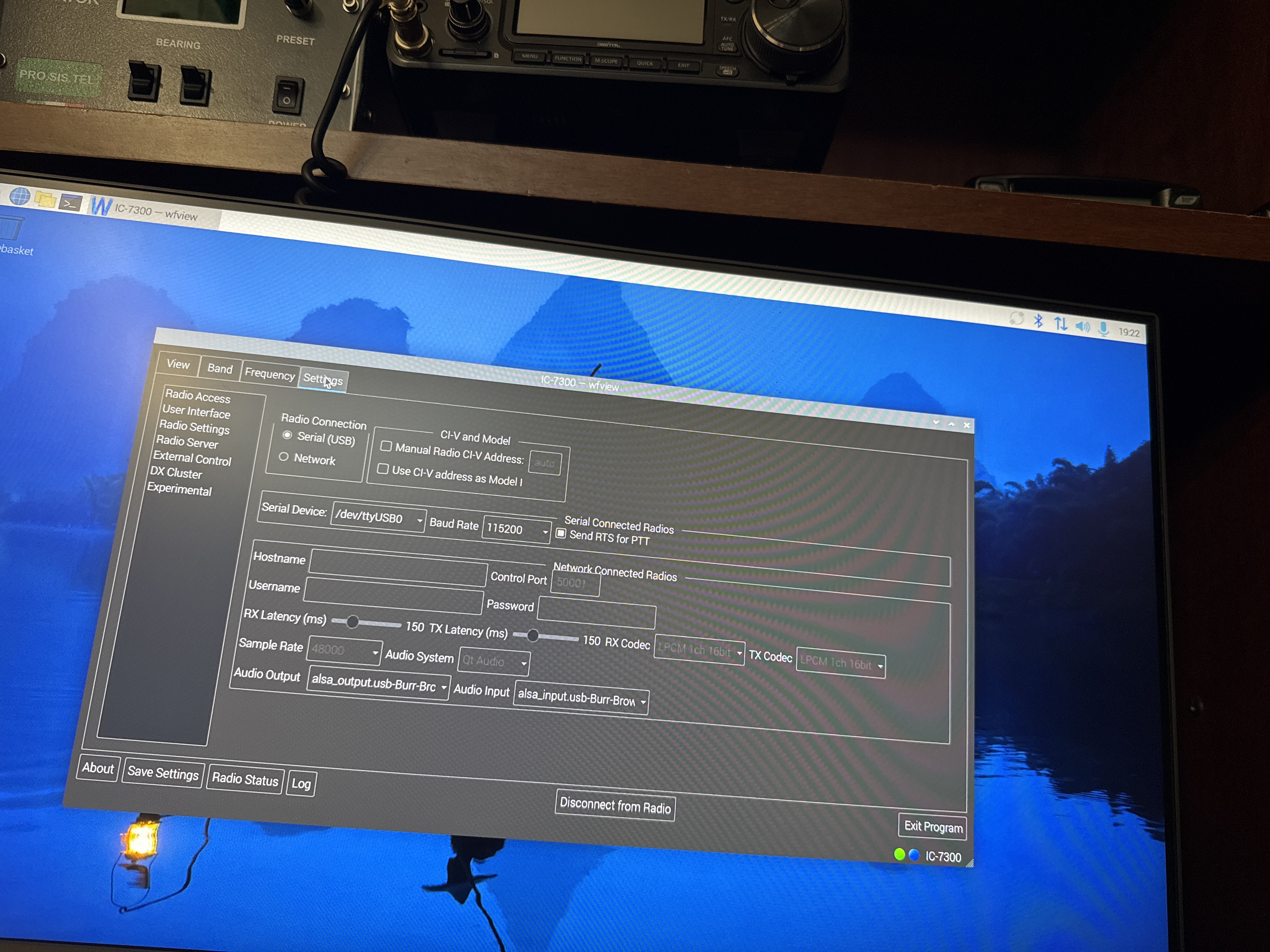

Hi when I starting the client I hear the microphone audio. It’s stranger I try to attach a screenshot of my Pi configuration.
I don’t think you understand what to do.
On the server, under “Radio Server”, what audio devices are selected?
Hi I have set the alsa burr-brown devices for audio I/O.
