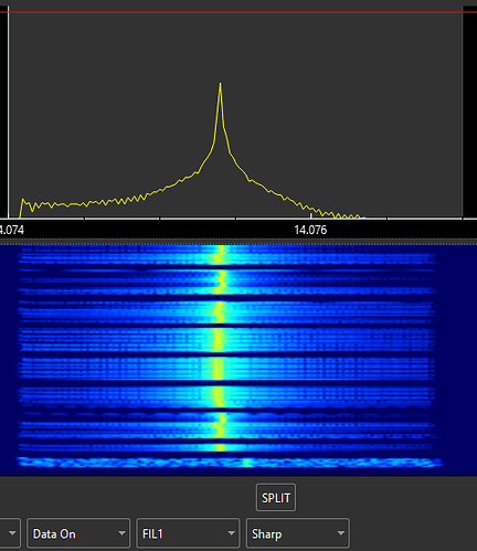

This is the audio scope when i transmit via SDR-Mobile on iphone:
