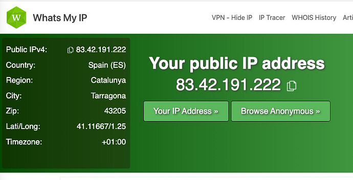

When I first arrived in Spain, my public IP address from the US worked fine with Wfview. Now that I have changed AirBNB’s, I had to do a search with “Whatsmyip.com” to find my new one. But the service here can’t detect the IPV6, just the IPV4 which doesn’t work to find my server.

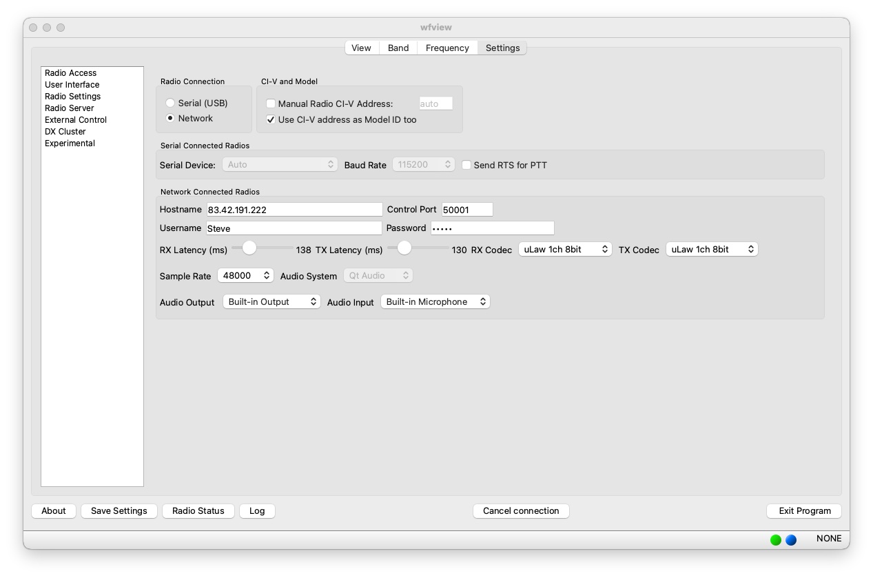

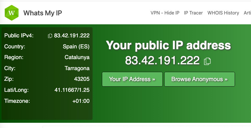

Here’s two screen shots. Any suggestions appreciated. In US, I have to use the IPv6 public address.

ok let me ask you some questions here.
you find your public address in Spain to be 83.42.191.222, also known as
222.red-83-42-191.dynamicip.rima-tde.net
and you put that in your wfview connection. Is this at the place where you did “the what’s my ip lookup”?
you also have CI-V address as model ID checked (don’t do that, unless you know why you need it)
now the question is. Where are you. Are you in .es? yes? And where is your rig located?
