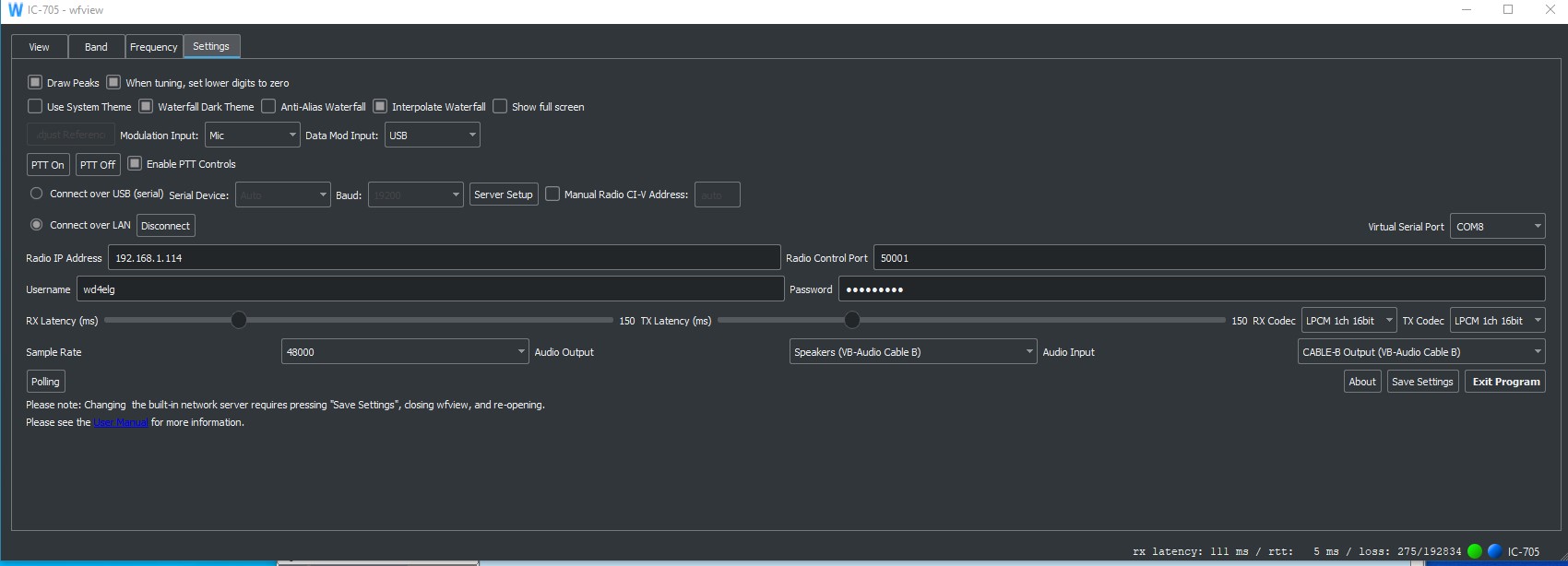

But that is NOT the screen I see under settings. Not even close. What I see is the attached file.
I am running 1.62x64, just downloaded today, March 2023 build. There is no menu on the left under settings to choose things like external control.

Please disregard. My PC was launching v1.1 even after I installed the latest version. So I installed in a separate folder and now I see the proper menus.
