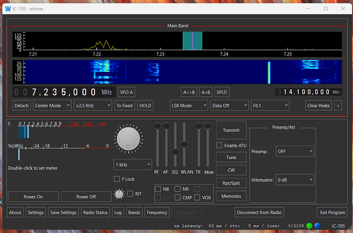

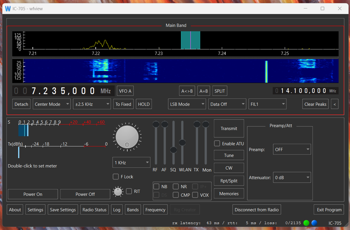

I’ve configured my IC-705 as a client on my Wi Fi network. When I launch wfview, the waterfall is odd, showing de-codable frequencies on both sides of the frequency as if it were set to AM, however it is set to LSB. See screen shot.
I hover over the waterfall and use my mouse roller to change frequency. It moves, but then locks up. wfview buttons still work, so I captured the log file and pasted it below.
Stand by for one more message to provide additional data.

2025-02-28 11:18:15.979 INF udp: udpCivData : No response for missing packet "0xa18" deleting
2025-02-28 11:18:15.979 INF udp: udpCivData : sending request for multiple missing packets :  "1f:0a:1f:0a:27:0a:27:0a:2d:0a:2d:0a:30:0a:30:0a:35:0a:35:0a:3d:0a:3d:0a:41:0a:41:0a:49:0a:49:0a:4f:0a:4f:0a"
2025-02-28 11:18:16.096 INF udp: udpCivData : No response for missing packet "0xa1f" deleting
2025-02-28 11:18:16.096 INF udp: udpCivData : sending request for multiple missing packets :  "27:0a:27:0a:2d:0a:2d:0a:35:0a:35:0a:3d:0a:3d:0a:41:0a:41:0a:49:0a:49:0a:4f:0a:4f:0a:54:0a:54:0a:5b:0a:5b:0a"
2025-02-28 11:18:16.204 INF udp: udpCivData : No response for missing packet "0xa27" deleting
2025-02-28 11:18:16.204 INF udp: udpCivData : No response for missing packet "0xa2d" deleting
2025-02-28 11:18:16.206 INF udp: udpCivData : No response for missing packet "0xa35" deleting
2025-02-28 11:18:16.206 INF udp: udpCivData : sending request for multiple missing packets :  "3d:0a:3d:0a:41:0a:41:0a:4f:0a:4f:0a:54:0a:54:0a:5b:0a:5b:0a:60:0a:60:0a:63:0a:63:0a"
2025-02-28 11:18:16.307 INF udp: udpCivData : sending request for missing packet :  "0xa73"
2025-02-28 11:18:17.184 INF udp: udpCivData : sending request for missing packet :  "0xadb"
2025-02-28 11:18:19.698 INF udp: udpCivData : sending request for missing packet :  "0xc1f"
2025-02-28 11:18:22.214 INF udp: udpCivData : sending request for missing packet :  "0xd5b"
2025-02-28 11:18:22.433 INF udp: udpCivData : sending request for missing packet :  "0xd6e"
2025-02-28 11:18:22.655 INF udp: udpCivData : sending request for missing packet :  "0xd8e"
2025-02-28 11:18:22.762 INF udp: udpCivData : sending request for missing packet :  "0xd9a"
2025-02-28 11:18:25.495 INF udp: udpCivData : sending request for missing packet :  "0xef2"
2025-02-28 11:18:25.604 INF udp: udpCivData : sending request for missing packet :  "0xef2"
2025-02-28 11:18:26.699 INF udp: udpCivData : sending request for missing packet :  "0xf88"
2025-02-28 11:18:26.813 INF udp: udpCivData : sending request for missing packet :  "0xf9d"
2025-02-28 11:18:28.341 INF udp: udpCivData : sending request for multiple missing packets :  "51:10:51:10:53:10:53:10"
2025-02-28 11:18:30.094 INF udp: udpCivData : sending request for missing packet :  "0x1132"
2025-02-28 11:18:30.635 INF udp: udpCivData : sending request for missing packet :  "0x117a"
2025-02-28 11:18:30.854 INF udp: udpCivData : sending request for missing packet :  "0x1197"
2025-02-28 11:18:31.512 INF udp: udpCivData : sending request for missing packet :  "0x11e5"
2025-02-28 11:18:32.714 INF udp: udpCivData : sending request for missing packet :  "0x1279"
2025-02-28 11:18:33.370 INF udp: udpCivData : sending request for multiple missing packets :  "c6:12:c6:12:cb:12:cb:12:d0:12:d0:12"
2025-02-28 11:18:33.478 INF udp: udpCivData : sending request for multiple missing packets :  "c6:12:c6:12:cb:12:cb:12:d0:12:d0:12:d8:12:d8:12:df:12:df:12"
2025-02-28 11:18:33.589 INF udp: udpCivData : sending request for multiple missing packets :  "c6:12:c6:12:cb:12:cb:12:d8:12:d8:12:e4:12:e4:12:eb:12:eb:12"
2025-02-28 11:18:33.697 INF udp: udpCivData : sending request for multiple missing packets :  "c6:12:c6:12:cb:12:cb:12:d8:12:d8:12:e4:12:e4:12:ef:12:ef:12:f3:12:f3:12:fa:12:fa:12"
2025-02-28 11:18:33.808 INF udp: udpCivData : No response for missing packet "0x12c6" deleting
2025-02-28 11:18:33.808 INF udp: udpCivData : No response for missing packet "0x12cb" deleting
2025-02-28 11:18:33.808 INF udp: udpCivData : sending request for multiple missing packets :  "d8:12:d8:12:e4:12:e4:12:ef:12:ef:12:f3:12:f3:12:fa:12:fa:12:01:13:01:13:07:13:07:13"
2025-02-28 11:18:33.920 INF udp: udpCivData : sending request for multiple missing packets :  "ef:12:ef:12:f3:12:f3:12:fa:12:fa:12:01:13:01:13:07:13:07:13:0e:13:0e:13:13:13:13:13"
2025-02-28 11:18:34.026 INF udp: udpCivData : sending request for multiple missing packets :  "f3:12:f3:12:fa:12:fa:12:01:13:01:13:07:13:07:13:0e:13:0e:13:18:13:18:13:1b:13:1b:13:24:13:24:13"
2025-02-28 11:18:34.135 INF udp: udpCivData : No response for missing packet "0x12f3" deleting
2025-02-28 11:18:34.136 INF udp: udpCivData : No response for missing packet "0x12fa" deleting
2025-02-28 11:18:34.136 INF udp: udpCivData : sending request for multiple missing packets :  "01:13:01:13:07:13:07:13:0e:13:0e:13:18:13:18:13:1b:13:1b:13:2c:13:2c:13"
2025-02-28 11:18:34.246 INF udp: udpCivData : No response for missing packet "0x1301" deleting
2025-02-28 11:18:34.246 INF udp: udpCivData : sending request for multiple missing packets :  "0e:13:0e:13:18:13:18:13:1b:13:1b:13:2c:13:2c:13"
2025-02-28 11:18:35.996 INF udp: udpCivData : sending request for missing packet :  "0x1415"
2025-02-28 11:18:36.543 INF udp: udpCivData : sending request for missing packet :  "0x1460"
2025-02-28 11:18:36.871 INF udp: udpCivData : sending request for missing packet :  "0x147e"
2025-02-28 11:18:38.729 INF udp: udpCivData : sending request for missing packet :  "0x156d"
2025-02-28 11:18:41.136 INF udp: udpCivData : sending request for missing packet :  "0x169c"
2025-02-28 11:18:44.854 INF udp: udpCivData : sending request for multiple missing packets :  "6b:18:6b:18:6e:18:6e:18"
2025-02-28 11:18:46.497 INF udp: udpCivData : sending request for missing packet :  "0x1938"
2025-02-28 11:18:47.809 INF udp: udpCivData : sending request for missing packet :  "0x19e3"
2025-02-28 11:18:48.135 INF udp: udpCivData : sending request for missing packet :  "0x1a0d"
2025-02-28 11:18:48.464 INF udp: udpHandler : sending request for missing packet :  "0x21f"
2025-02-28 11:18:50.761 INF udp: udpCivData : sending request for missing packet :  "0x1b55"
2025-02-28 11:18:51.528 INF udp: udpCivData : sending request for missing packet :  "0x1bbb"
2025-02-28 11:18:51.747 INF udp: udpCivData : sending request for missing packet :  "0x1bd4"
2025-02-28 11:18:53.277 INF udp: udpCivData : sending request for missing packet :  "0x1c90"
2025-02-28 11:18:53.389 INF udp: udpCivData : sending request for missing packet :  "0x1c9e"
2025-02-28 11:18:53.608 INF udp: udpCivData : sending request for missing packet :  "0x1cb2"
2025-02-28 11:18:53.715 INF udp: udpCivData : sending request for missing packet :  "0x1cc1"
2025-02-28 11:18:53.830 INF udp: udpCivData : sending request for multiple missing packets :  "c9:1c:c9:1c:cf:1c:cf:1c:d3:1c:d3:1c"
2025-02-28 11:18:53.932 INF udp: udpCivData : sending request for multiple missing packets :  "d7:1c:d7:1c:e1:1c:e1:1c"
2025-02-28 11:18:56.230 INF udp: udpCivData : sending request for missing packet :  "0x1dfb"
2025-02-28 11:18:56.667 INF udp: udpCivData : sending request for missing packet :  "0x1e34"
2025-02-28 11:18:57.103 INF udp: udpCivData : sending request for missing packet :  "0x1e67"
2025-02-28 11:18:57.761 INF udp: udpCivData : sending request for missing packet :  "0x1eba"
2025-02-28 11:18:59.074 INF udp: udpCivData : sending request for missing packet :  "0x1f64"
2025-02-28 11:18:59.296 INF udp: udpCivData : sending request for missing packet :  "0x1f7c"
2025-02-28 11:18:59.402 INF udp: udpCivData : sending request for multiple missing packets :  "7c:1f:7c:1f:8a:1f:8a:1f"
2025-02-28 11:18:59.515 INF udp: udpCivData : sending request for multiple missing packets :  "7c:1f:7c:1f:94:1f:94:1f:99:1f:99:1f:9c:1f:9c:1f"
2025-02-28 11:18:59.625 INF udp: udpCivData : sending request for multiple missing packets :  "7c:1f:7c:1f:99:1f:99:1f:9c:1f:9c:1f:a0:1f:a0:1f"
2025-02-28 11:18:59.729 INF udp: udpCivData : No response for missing packet "0x1f7c" deleting
2025-02-28 11:18:59.729 INF udp: udpCivData : sending request for multiple missing packets :  "9c:1f:9c:1f:a0:1f:a0:1f:ad:1f:ad:1f"
2025-02-28 11:18:59.839 INF udp: udpCivData : sending request for multiple missing packets :  "9c:1f:9c:1f:a0:1f:a0:1f:ad:1f:ad:1f:b7:1f:b7:1f"
2025-02-28 11:18:59.948 INF udp: udpCivData : No response for missing packet "0x1f9c" deleting
2025-02-28 11:18:59.948 INF udp: udpCivData : sending request for multiple missing packets :  "ad:1f:ad:1f:b7:1f:b7:1f:c7:1f:c7:1f:cc:1f:cc:1f:cd:1f:cd:1f"
2025-02-28 11:19:00.059 INF udp: udpCivData : sending request for multiple missing packets :  "ad:1f:ad:1f:c7:1f:c7:1f:cc:1f:cc:1f:cd:1f:cd:1f:d4:1f:d4:1f:d6:1f:d6:1f:da:1f:da:1f"
2025-02-28 11:19:00.168 INF udp: udpCivData : No response for missing packet "0x1fad" deleting
2025-02-28 11:19:00.168 INF udp: udpCivData : sending request for multiple missing packets :  "c7:1f:c7:1f:cc:1f:cc:1f:cd:1f:cd:1f:d4:1f:d4:1f:d6:1f:d6:1f:da:1f:da:1f:e2:1f:e2:1f:e9:1f:e9:1f"
2025-02-28 11:19:01.049 INF udp: udpCivData : sending request for missing packet :  "0x2051"
2025-02-28 11:19:02.245 INF udp: udpCivData : sending request for missing packet :  "0x20f0"
2025-02-28 11:19:02.356 INF udp: udpCivData : sending request for multiple missing packets :  "f0:20:f0:20:fd:20:fd:20"
2025-02-28 11:19:02.470 INF udp: udpCivData : sending request for multiple missing packets :  "f0:20:f0:20:fd:20:fd:20:04:21:04:21"
2025-02-28 11:19:02.575 INF udp: udpCivData : sending request for multiple missing packets :  "f0:20:f0:20:fd:20:fd:20:04:21:04:21:10:21:10:21:13:21:13:21:18:21:18:21"
2025-02-28 11:19:02.686 INF udp: udpCivData : No response for missing packet "0x20f0" deleting
2025-02-28 11:19:02.687 INF udp: udpCivData : sending request for multiple missing packets :  "fd:20:fd:20:04:21:04:21:10:21:10:21:13:21:13:21:18:21:18:21:1d:21:1d:21:22:21:22:21"
2025-02-28 11:19:02.796 INF udp: udpCivData : No response for missing packet "0x20fd" deleting
2025-02-28 11:19:02.796 INF udp: udpCivData : sending request for multiple missing packets :  "04:21:04:21:10:21:10:21:13:21:13:21:1d:21:1d:21:22:21:22:21:2a:21:2a:21:2f:21:2f:21"
2025-02-28 11:19:02.901 INF udp: udpCivData : No response for missing packet "0x2104" deleting
2025-02-28 11:19:02.901 INF udp: udpCivData : sending request for multiple missing packets :  "10:21:10:21:37:21:37:21:38:21:38:21"
2025-02-28 11:19:03.011 INF udp: udpCivData : No response for missing packet "0x2110" deleting
2025-02-28 11:19:03.012 INF udp: udpCivData : sending request for multiple missing packets :  "38:21:38:21:45:21:45:21:48:21:48:21:4c:21:4c:21:50:21:50:21"
2025-02-28 11:19:03.127 INF udp: udpCivData : sending request for multiple missing packets :  "38:21:38:21:45:21:45:21:48:21:48:21:4c:21:4c:21:50:21:50:21:58:21:58:21:60:21:60:21"
2025-02-28 11:19:03.228 INF udp: udpCivData : sending request for multiple missing packets :  "38:21:38:21:45:21:45:21:48:21:48:21:4c:21:4c:21:50:21:50:21:58:21:58:21:60:21:60:21"
2025-02-28 11:19:03.996 INF udp: udpCivData : sending request for missing packet :  "0x21c1"
2025-02-28 11:19:07.934 INF udp: udpCivData : sending request for missing packet :  "0x23b7"
2025-02-28 11:19:09.135 INF udp: udpCivData : sending request for missing packet :  "0x2448"
2025-02-28 11:19:09.469 INF udp: udpCivData : sending request for missing packet :  "0x2479"
2025-02-28 11:19:09.576 INF udp: udpCivData : sending request for missing packet :  "0x247e"
2025-02-28 11:19:10.562 INF udp: udpCivData : sending request for missing packet :  "0x2503"
2025-02-28 11:19:10.668 INF udp: udpCivData : sending request for missing packet :  "0x2505"
2025-02-28 11:19:11.988 INF udp: udpCivData : sending request for missing packet :  "0x25b2"
2025-02-28 11:19:12.421 INF udp: udpCivData : sending request for missing packet :  "0x25e9"
2025-02-28 11:19:13.625 INF udp: udpCivData : sending request for missing packet :  "0x2681"
2025-02-28 11:19:15.484 INF udp: udpCivData : sending request for missing packet :  "0x275f"
2025-02-28 11:19:17.339 INF udp: udpCivData : sending request for missing packet :  "0x2848"
2025-02-28 11:19:18.109 INF udp: udpCivData : sending request for missing packet :  "0x28b3"
2025-02-28 11:19:18.761 INF udp: udpCivData : sending request for missing packet :  "0x28fb"
2025-02-28 11:19:19.963 INF udp: udpCivData : sending request for missing packet :  "0x2994"
2025-02-28 11:19:20.729 INF udp: udpCivData : sending request for missing packet :  "0x29fa"
2025-02-28 11:19:20.846 INF udp: udpCivData : sending request for missing packet :  "0x2a02"
2025-02-28 11:19:21.935 INF udp: udpCivData : sending request for missing packet :  "0x2a89"
2025-02-28 11:19:22.588 INF udp: udpCivData : sending request for missing packet :  "0x2ad9"
2025-02-28 11:19:23.246 INF udp: udpCivData : sending request for missing packet :  "0x2b2d"
2025-02-28 11:19:23.573 INF udp: udpCivData : sending request for missing packet :  "0x2b58"
2025-02-28 11:19:23.901 INF udp: udpCivData : sending request for missing packet :  "0x2b81"
2025-02-28 11:19:25.567 INF udp: Got Connection status for: IC-705 Busy: 0 Computer  IP "0.0.0.0"
2025-02-28 11:19:27.950 INF udp:  CIV Watchdog: no CIV data received for 2s, requesting data start.
2025-02-28 11:19:56.028 INF udp:  Audio Watchdog: no audio data received for 30s, restart required? last: QTime("11:19:25.554")
2025-02-28 11:19:56.030 INF audioconverter: Closing audioConverter() Input: 1 Channels of 0 16000 Int16 Output: 2 Channels of 0 48000 Float
2025-02-28 11:19:56.046 INF audioconverter: Closing audioConverter() Input: 1 Channels of 0 48000 Float Output: 1 Channels of 0 16000 Int16
2025-02-28 11:23:25.531 INF udp: udpHandler : sending request for missing packet :  "0xcf7"
2025-02-28 11:23:25.761 INF udp: udpHandler : sending request for missing packet :  "0xcfa"
2025-02-28 11:23:26.189 INF udp: udpHandler : sending request for missing packet :  "0xcfe"
2025-02-28 11:25:00.670 INF udp: udpHandler : sending request for missing packet :  "0x10b1"
Your post was edited to include three back ticks prior to and after the pasted log file contents. Please consider this next time.
Follow-up: I had to test this before posting. If I launch wfview and change to AM, then back to LSB, the system operates just fine. I can QSO using the mouse roller just fine and the system does not lock up.
The number of missing/retransmitted packets is the problem.
This is generally caused by poor WiFi signal (the IC-705 needs to be positioned quite near an AP to work reliably, due to the built-in antenna). We have also found that lower quality access points are just not capable of sending/receiving the number of packets required for reliable UDP audio streaming (upwards of 200 per second is typical).
I would recommend making sure that the IC-705 is positioned as close to the AP as possible. You can also try a lower sample rate in the connection tab within settings, 16 KHz will result in a 75% reduction in the number of packets (compared to the default 48 KHz) but a barely noticeable reduction in quality.
Thank you for your quick reply. I added information just before you replied. Restating here, if I set mode to AM and then back to LSB, this symptom does not appear. wfview operates as expected and does not lock up. Btw…the ‘705 and AP are within 10’ of each other and I am using 16 kHz, too.
Additional (very odd) information: If I exit while on 7 MHz and re-launch wfview, the reported symptom presents. If I exit while on 14 MHz and re-launch wfview, the display is as expected and does not lock up.
Does the 705 have A/B VFOs? Check the modes of each A and B, perhaps make them the same or different in your tests.
