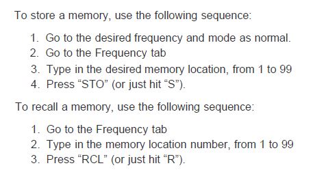

Here is what I have tried many times… Let’s say in the main UI I change the frequency to 14.025. I then go to the frequency tab (not the memory tab) enter a number to store the memory frequency like the manual says and then hit STO. When I try to recall the memory I go to the frequency tab and put in the number that I wanted the frequency to be stored in and hit recall. And nothing!!!
No recall. So what am I doing wrong. Describe step by step how you do it if you would please.

Ah that is the old memory system which was very basic, it will likely be removed soon.
wfview now supports programming the memories stored in your radio, via the Memories button on the main wfview screen.

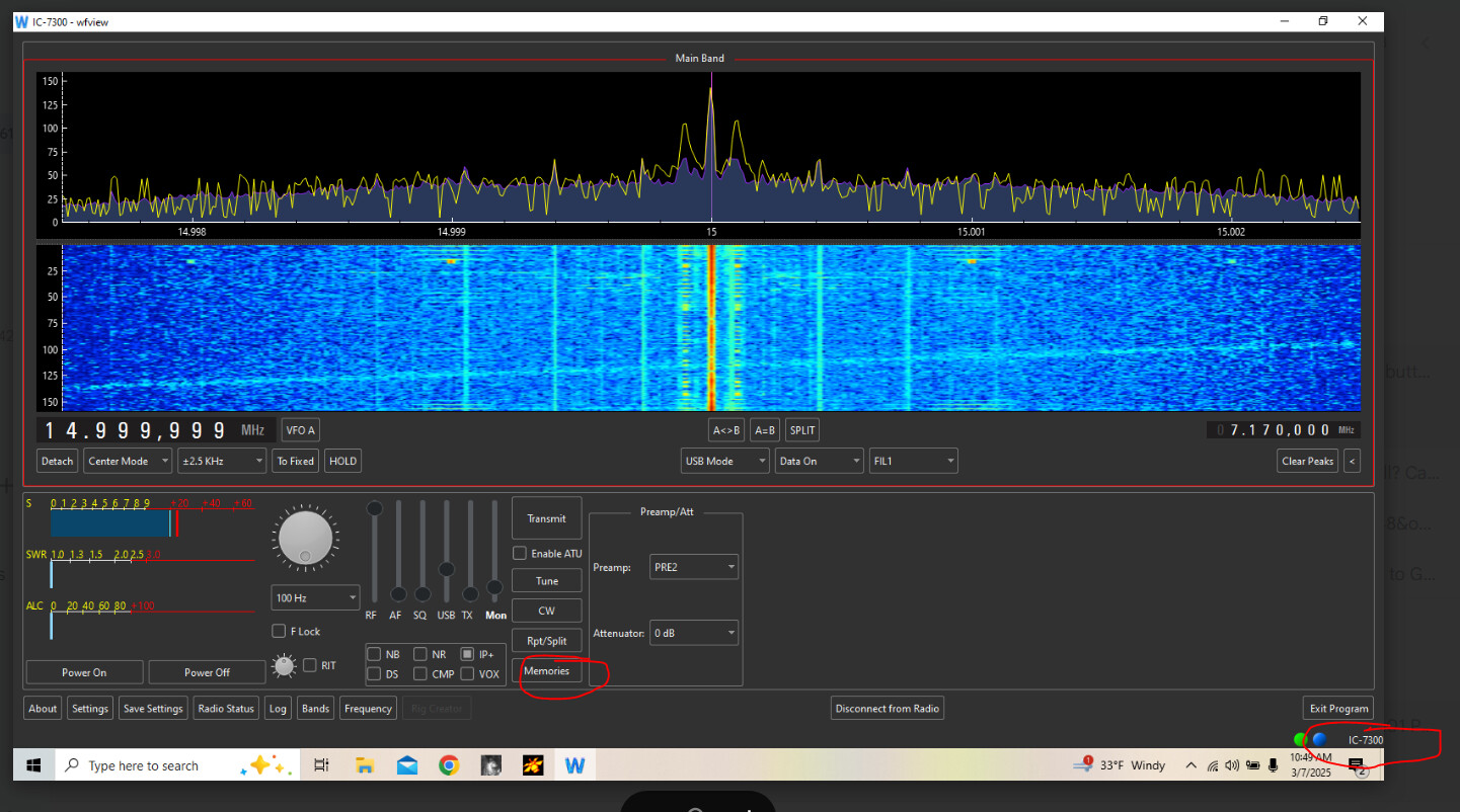

Are you actually connected to the radio? Does it say IC-7300 in the bottom right hand corner of the main window?

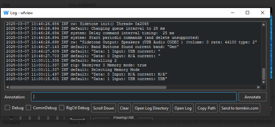

Screenshots and information from the log window would greatly assist us here, as so far we have very little information on your setup.
Screenshot… lot to follow
I see and installation log. That is the only log I see. Is that what you want???
Found it… remember I am new to this program
That all looks OK, What happens when you click on the Memories button? You should get a popup window warning you it is an experimental feature, click OK on that.
Yep. All the frequencies I stored manually in the radio pop up and if I click on one of them the radio changes to that frequency. Has me baffled. I usually don’t have many problems, but when I do I usually can figure them out. May be time to drop back five yards and punt. The only thing that comes to my mind is baud rate, but I can pretty much eliminate that as the rest of the program is functioning.

If you are talking about the STO/RCL buttons within the Frequency window, they will not work (which is why I said they will likely be removed)
