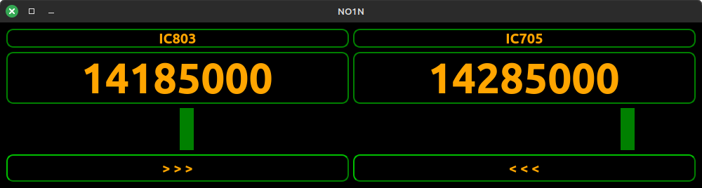

I have a first draft of a rigctld based controller. It handles two rigs now (could be n rigs) and can clone one to the other via the arrows. I use the mouse/wheel on the sliders to change frequency, but it can be directly entered in the QLineEdit box.
It also controls Wfview thru rigctld, which is great because the IC-705 creates RFI when using USB, but not with WiFi. So a laptop can display the waterfall, and be controlled via rigctld.
