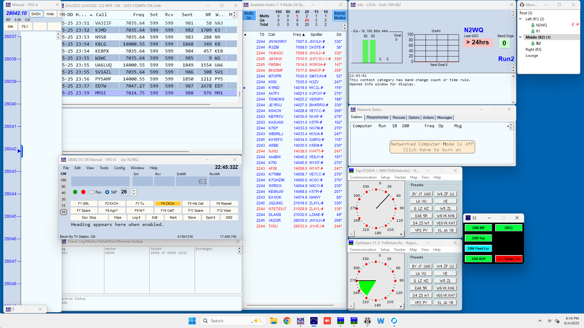

Here’s what 1920 x 1080 screen looks like in a multi-op setup:
