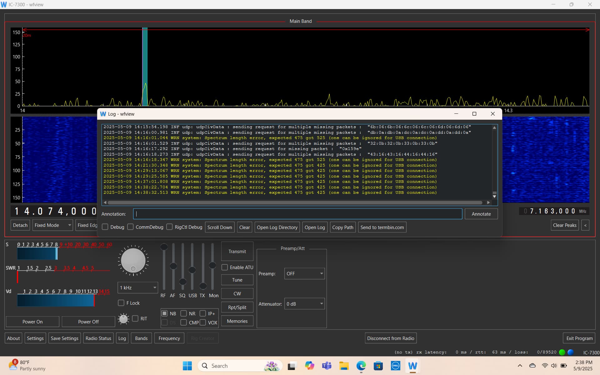

Audio problems: Rig IC 7300, Server PC on windows 11 works great with the transceiver and also connects to the client PC running on my cell phone hotspot. version 2.10 on both machines. Just no receive or transmit audio on client. In Radio Settings/data off modulation input box set to USB but switches to MIC when I connect radios. same for data 1 box. Log says it keeps requesting missing packets. Help greatly appreciated!

How is the audio source set on the server side (RX Audio Input and TX Audio Output)? Verify these are set correctly and try re-connecting your client.
On the client side, set one of the meters to “RxAudio” and let’s see if it moves any.
Thanks for your reply, E
Rx Audio on client side does not move.
