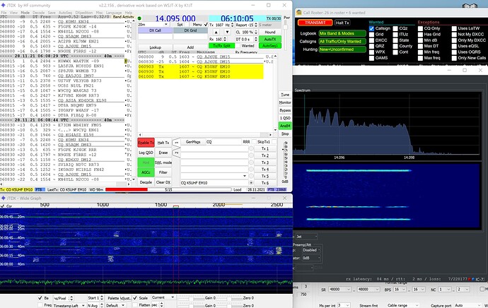

Making a lot of progress getting wfview working remotely, but ran into a weird issue. Here is my set up:
Radio: Icom IC-7300
Wfview server: Raspberry Pi 4 (Debian Buster) w/USB to radio and ethernet to Lan
Remote PC: Surface Pro 8
Software: Wfview, JTDX, DXKeeper, GridTracker, Virtual Audio Cable
Rig control and audio work, but when I transmit on FT8, it uses 2-3kHz…instead of 50Hz. See attached screenshot. Not sure if this is a bug or configuration issue.

Hi Jeff,
Not sure I understand what you mean? How is JTDX connected to wfview? I personally recommend using rigctld rather than using a virtual serial port. The only caveat is you must use ‘fake it’ split mode currently within JTDX as rig controlled split isn’t implemented at the moment.
73 Phil M0VSE

Hi Phil,
I am using “Hamlib NET rigctl” in JTDX with 127.0.0.1:4533 as the Network Server. I followed the audio configuration guide in the manual using Virtual Audio Cable. I am not using any virtual serial ports (very happy not to have to deal with that as well!). The weird issue with wide bandwidth went away after a reboot. I have been able to make some QSOs, so it appears to be working…just some intermittent issues with rig control where it gets stuck in TX mode, but is not actually transmitting anything.
