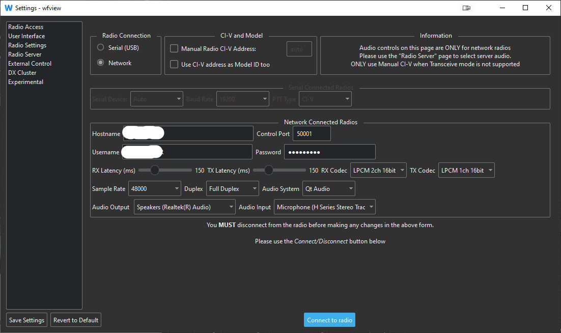

From what I understand of the docs…to get the ‘duplex’ mode we want for satellites, you need the 2ch… If I use the Icom software, I can mute the one channel and combine the other. I am sure I can manually do this in the windows mixer maybe…
I’ve never needed to monitor my transmit frequency (uplink) much during satellite operation. Only briefly to see that it isn’t in use I suppose.
Since I am using full duplex, I am using both VFOs - “RX Codec and TX Codec: Select the audio encoding scheme to use. The radio must support the selected stream. Use a 2ch (“stereo”) stream for radios that have dual VFOs (or if you are only using one VFO, use a 1ch stream.)”

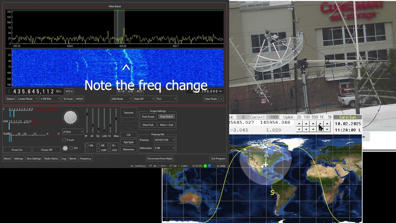

As I test in satellite mode, it all seems to work fine…
however, the wfview display doesn’t really reflect what the radio is doing, which is a bit uncomfortable for remote use.
I will have to test my theory sitting next to the radio…but I think the frequencies are being updated, there are no errors in the log (just expected comments “FA” see pg23 of the 9700CI-V manual) it just doesn’t update the wfview display…I assume the correct bands are in use because the waterfall itself shows the MAIN downlink freq, and the freq display below the waterfall shows the SUB uplink.
However what bothers me is I think the mode is changing correctly (FM vs USB etc) but there is nothing on the display to reflect that. I assume that would ‘simply’ involve monitoring CAT commands and put up the appropriate indicator on the software display.
It ‘sounds’ like the modes change appropriately. (haven’t made an SSB contact yet to prove that)

Maybe you can give your settings…when I have it set to 1ch the receive turns off when I transmit. When in 2ch the receive continues while I transmit.
The Icom software does the exact same thing…need to be in 2ch to hear the downlink while you transmit.

BTW, this is what I (we?) mean when we talk about remote satellite operation. Wfview does work…any issues, I blame on the Icom side…however just prior to this video I had to restart Wfview…it was simply locked up…although I could hear audio.

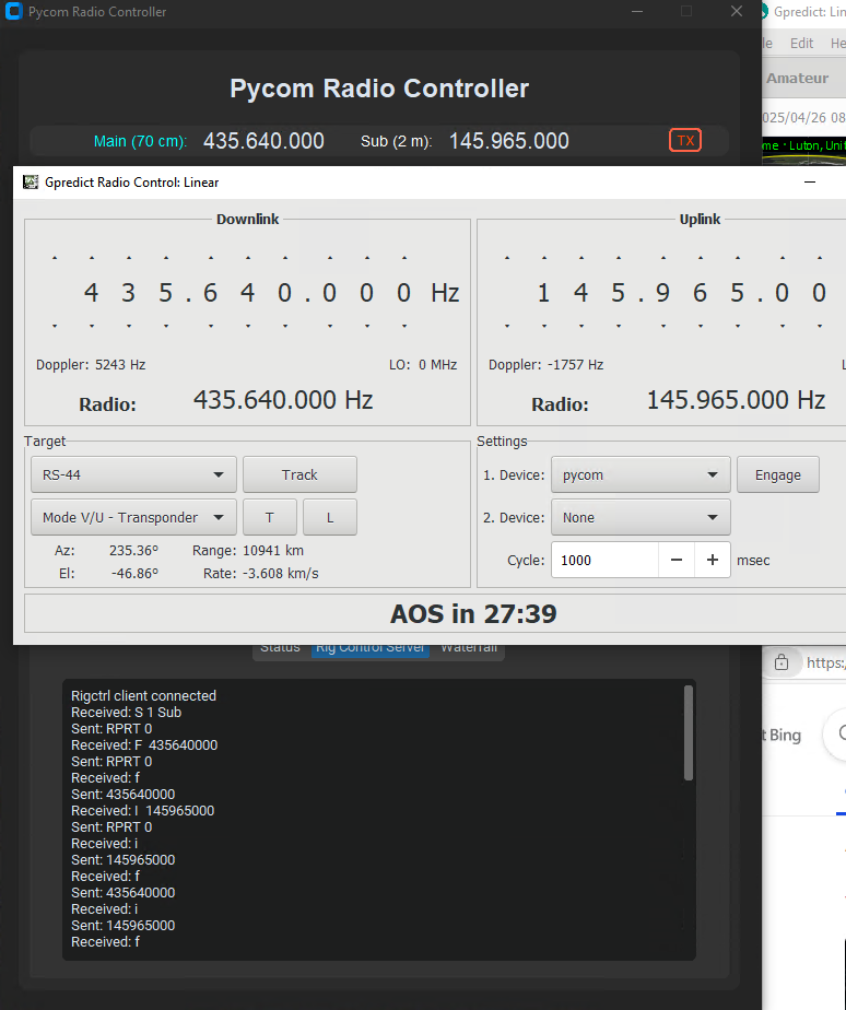

I ended up building my own Pycom Radio Controller - Cover It has an example of it working with Gpredict full doppler: https://youtu.be/BbH3cdgckKA

As discussed above when updating the radio the screen flickers between the main/sub bands for reading and updating. I do this in a background thread and as far as the app is concerned it doesn’t see it/change the UI or the audio channel and so hidden away. The frequencies are still updated, but there’s no flickering as such.
