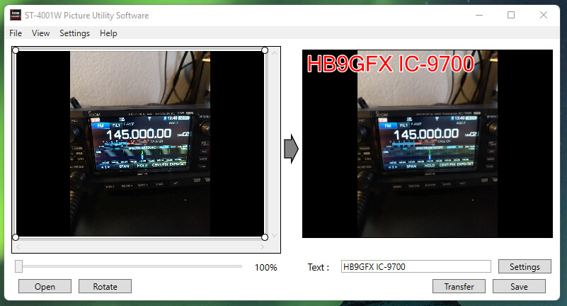

So from my view, it should be possible to access the SD Card over Lan. ST4001 Software is exactly doing that.
You need to add the IP Adress of the radio. Then it sends the picture to the folder picture of your SD-Card.
So there is a function to do this.

As Elliott mentioned on your other thread, somebody has already reverse-engineered the protocol https://github.com/sq5t/ic-705-tools
Unfortunately, it appears to ONLY support images over that interface, and there also looks to be no method to retrieve a directory listing of the SD card, so direct access is unlikely to be possible. While access to other parts of the SD card ‘may’ be possible, as there is currently no software available that does this, it would be very difficult (practically impossible) to work out how.
73 Phil M0VSE
and for the record ; “wit” should work on the 705, 9700 and any other icom that supports D* and image xfers over 60000/TCP
