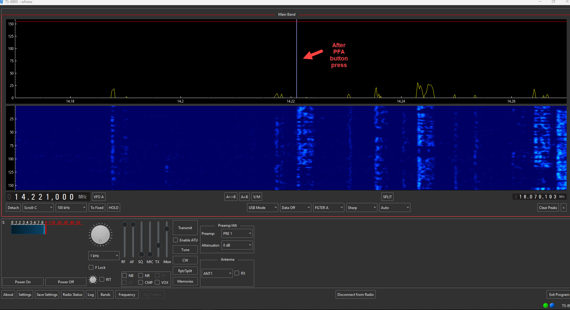

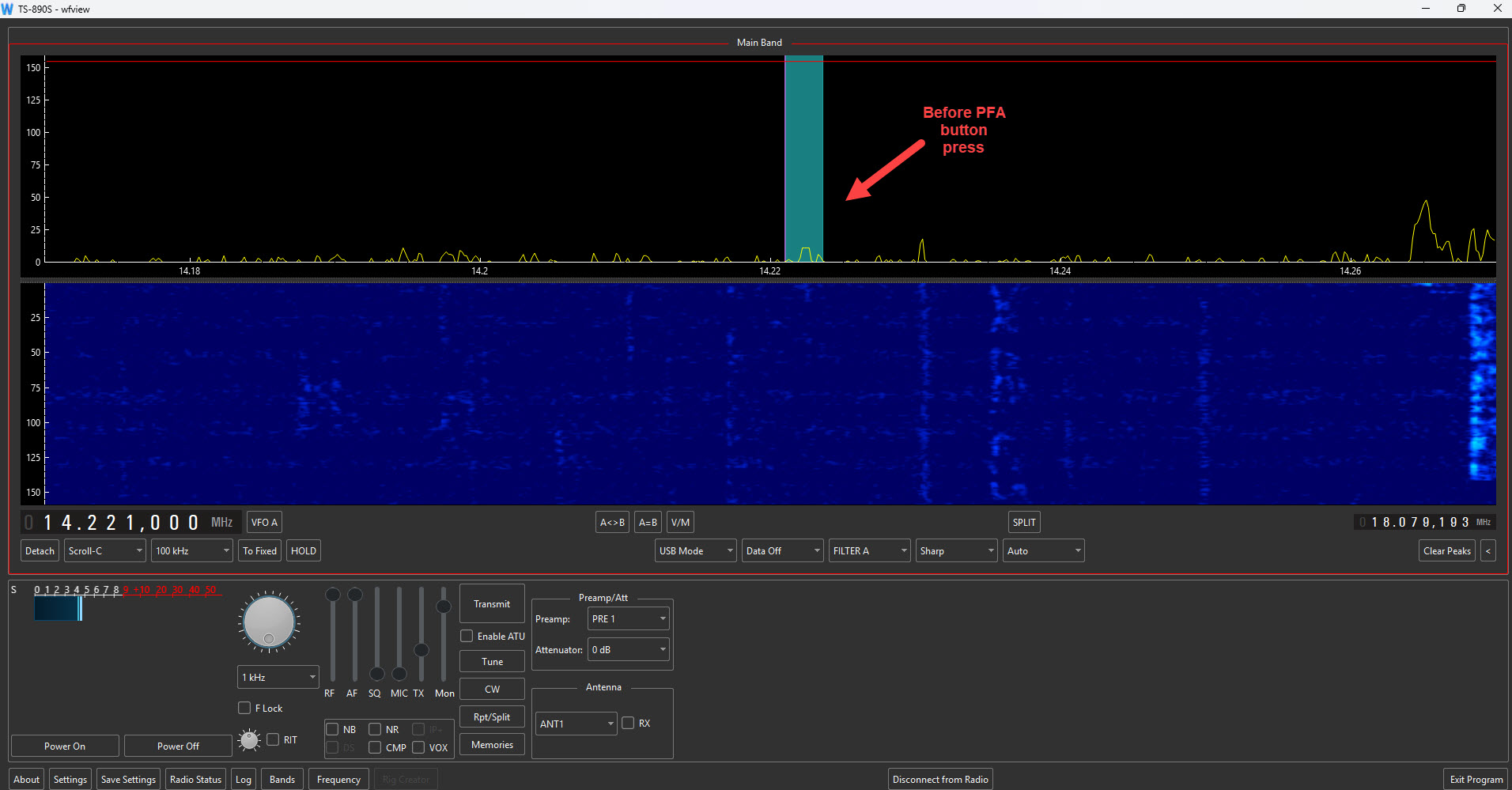

What I did: I started WFVIEW and connected to radio. I changed to 20m band. I hit the PFA button on the radio which starts transmitting a carrier for my remote tuner.
Expected behavior: The bandwidth display on the signal portion should not change
Observed behavior: The bandwidth display changes from 3KHz no bandwidth. I have before and after images. Image 1 is before the PFA button is pressed and Image 2 is after the press.
The method of determining the RX passband is something that we are working on at the moment, as unlike Icom radios (which send the actual passband bandwidth as a value). Kenwood (and Yaesu) return a number which represents the passband depending on which mode is currently in use. I can only assume that pressing the PSA button breaks the particular method we are using?

It does not. After the PFA button is released, it looks like the screenshot in image 2 unless I restart the software.
