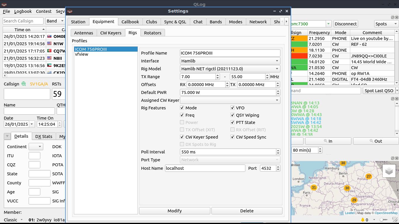

Also, how are you connecting QLog to wfview?

Qlog to WFview trough Hamlib
