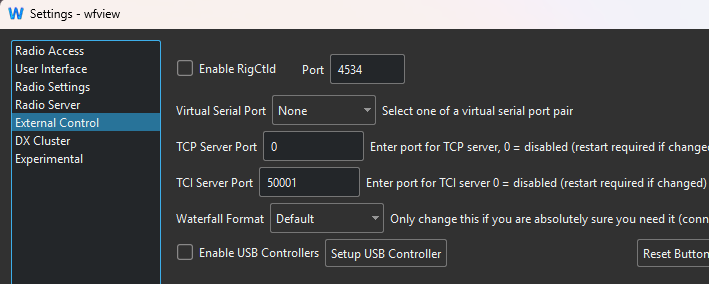

HI,
I am connecting Wfview to my Icom IC-705 via WiFi/Lan and everything works fine except external control from DX Lab Commander. According to the documentation there is built in virtual serial port in Wfview, but the only available ports in my PC (Win11) and in Wfview are COM9 and COM10 which both are for serial bluetooth.
So my question is; did I get this wrong or have a missed some step to activate the virtual serial ports?
73
Sven

I have read but not understood why I’m asking.
"The built-in virtual serial port option of wfview lets a second program control the radio over a pseudo-terminal device. "
I don’t see any built in virtual serial port in Wfview?
Do I have to install a separate virtual serial port that Wfview can use?
/Sven

Keep reading. It’s there.
Second line. I used it on Linux, have not tried it on Windows yet.
