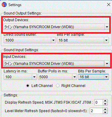

MSHV Options-Sound Settings
1.Select the “virtual audio” setting.
MSHV-wfview2
DE JG3HLX NAKAO
