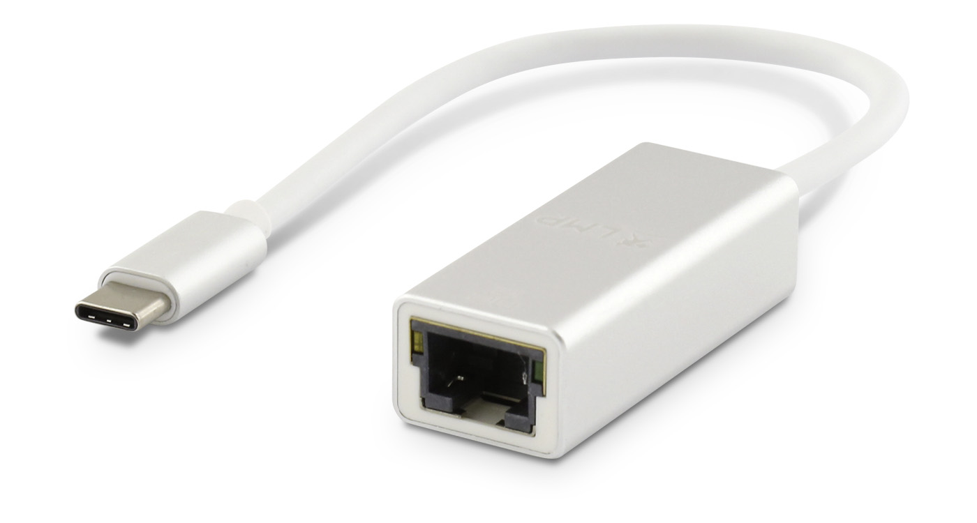

With an Ethernet dongle, it works nicely without a packet loss and with a low latency.

I use a LMP USB-C to Gigabit Ethernet adapter.
Michel, HB9DUG

Which dingle did you use?
