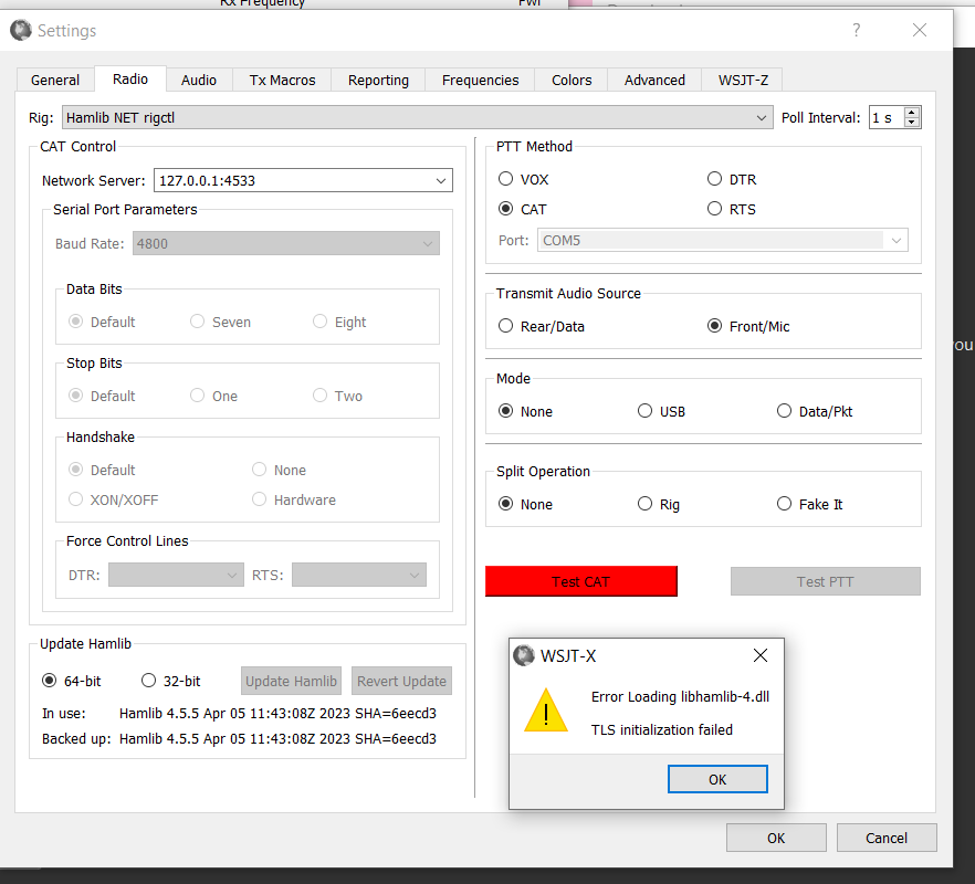

Anyone else unable to use Hamlib on WSJT? Trying to use it on the local instance.
Did you install the OpenSSL libraries as directed by the WSJT-X User Guide?
this is happening to our IC7100 also. Server on Debian 12, clients on Windows 10 - no audio from the client to the server is working, so not possible to TX any audio, and audio from server to client is only working sometimes.
swapping back to the 1.6x binary on the server restores audio instantly.
I went ahead and installed it (never needed it before). Still not functioning. Error showed up when i clicked ‘Update Hamlib’. Worked perfectly with prior version.
It is a pre-release version for a reason :grinning: you are probably best to go back to the stable version.
