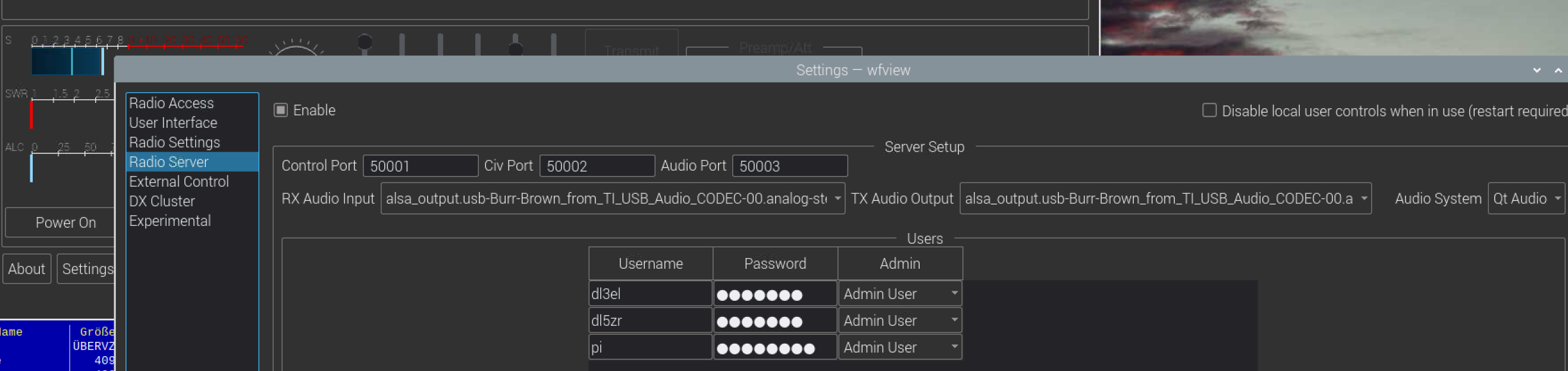

the rx audio input was empty after the upgrade. I was also not available for the local WSJT-X installation,after a reboot it looks like attached. For me it seems ok

one important info, just discovered: before I did the upgrade, I copied /usr/local/bin/wfview to wfview.203. When I now switch back to that version on the Raspberry, the sound on my local W11 Client (with wfview 2.10) starts immediatly.
It’s quite possible that the device names have changed, as 2.10 uses a newer version of the Qt framework.
You can also try PA or RT audio systems, rather than the default QT one.
